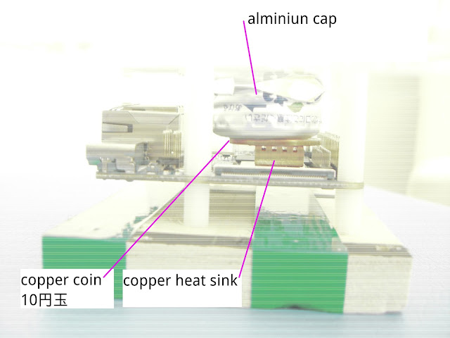

my heat sink is https://3.bp.blogspot.com/-y70Z5NsQw1I/V3HmOkX8HWI/AAAAAAAABFU/oR23tBq9y... but i cannot know the temperature of CPU .
tkaser teach me . cat /sys/class/hwmon/hwmon0/device/temp_label and max temperature is 88 while do ing 'sysbench --test=cpu --cpu-max-prime=200000 run --num-threads=8' .
